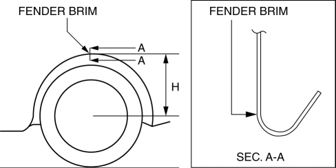

    10 mm wäre exakt die von Mazda angegebene Toleranz im Serienzustand.
    WHEEL ALIGNMENT PRE-INSPECTION | 2016 ND Shop Manual
    < Previous Next > 1. Park the vehicle on level ground, in an unloaded condition*, with the wheels straight forward. *: Unloaded condition, fuel tank is full.…
