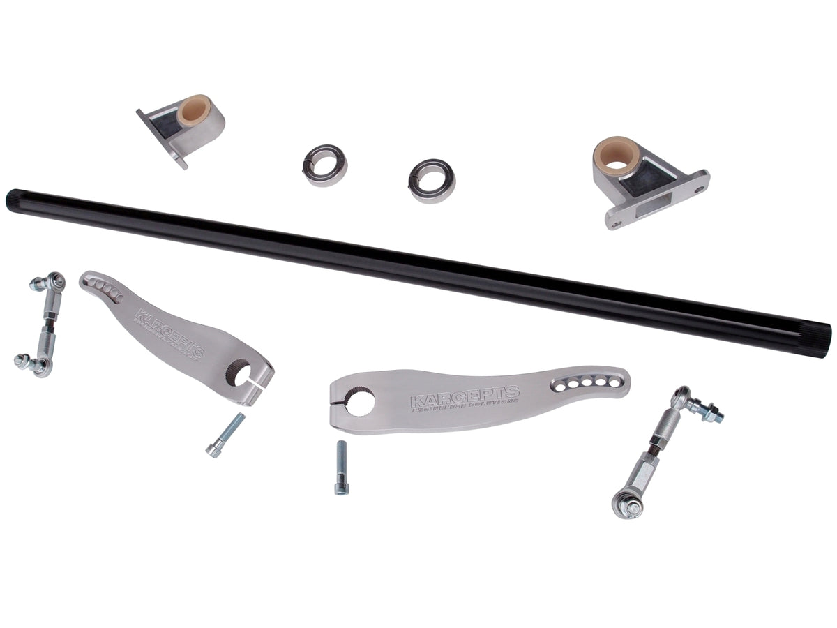

  • Der Stabilisator von Karcepts ist angeblich gewichtsoptimiert:
    Karcepts ND Front Sway Bar Kit
    Designed for serious competitors, the Karcepts ND Front Sway Bar Kit leaves no compromises on the table. Hundreds of hours of design time have gone into this…
    karcepts.com
